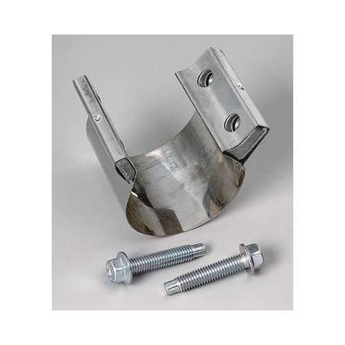

has anyone ever tried this new type of clamp. its a wide band as opposed to a u-bolt.
http://www.amazon.com/Walker-33240-E.../dp/B0006HLFB0

The u-bolt style clamps hold the pipes together by crimping them. No pulling apart with those, unless you use the hot wrench. The band clamps aren't nearly as affective. If you would rather use them though, cut the sides of the pipe up about three quarters of what you expect pipe overlap to be. That gives the clamp the chance to actually hold the pipes together.
