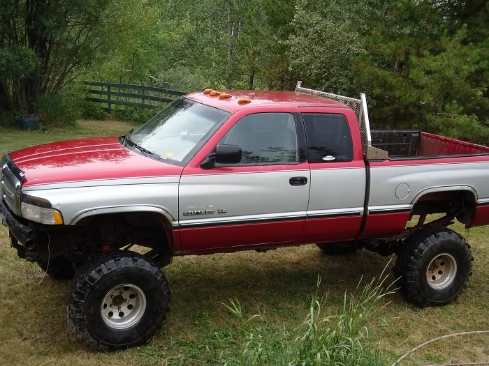

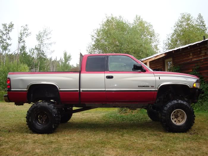

Sorry to hijack your thread, but here you go -
10'' of suspension lift, and 3'' body lift. Those are 38'' TSLs in the photos. It will clear 44s with room to spare, but that's a little too much tire for the 1/2 ton diffs. The 40'' LTBs I have on it now work excellent with the 4.56 gears and the 318 is still running strong. Hands down the toughest rig I've ever owned.
