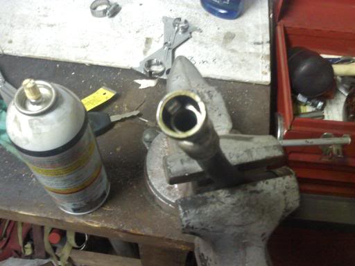

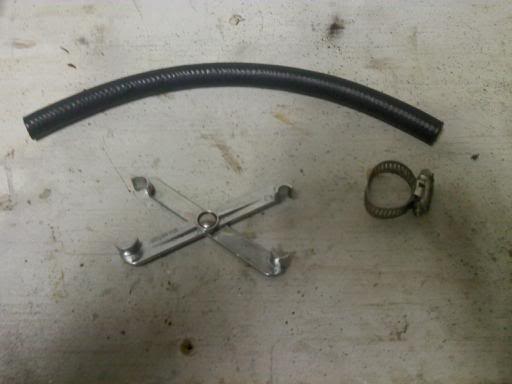

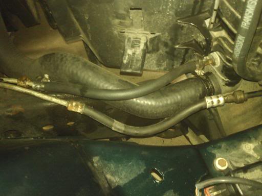

like 18ins of hose and two clamp
and just a dis-con-neck tool
here is the view of were and what the dis tool need to move those tabs
i side it over the flair and clamped it
