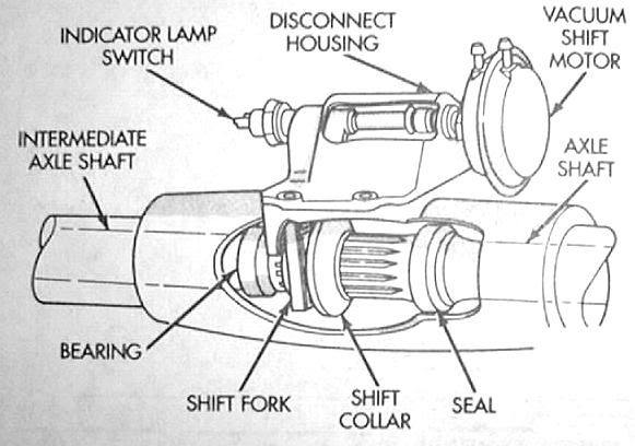

Right. Just a seal on the outer part of CAD. The needle bearing is on the inner or left side of CAD. The intermediate shaft has to come out to replace it. That is where the large one goes. I bet if you grab the end of the intermediate shaft with your fingers it will wobble up and down. The smaller bushing, goes in the end of the outer shaft where it mates to the pin on the inner shaft. And no auto parts store will carry either.
EDIT this picture shows where the larger one goes.

OK I've been looking at these pictures, and don't see "where the large one goes", so please help.
Seal you can buy at an auto supply store
Shift collar I still have
Shift fork is attached to the CAD housing
The bearing (which I need to replace)
So then where does the "large one go"?
