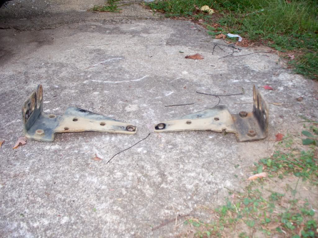

i have these ill sell you for $40 plus shipping, they should bolt right into factory locations. pulled them off my truck to put a bull bar on
