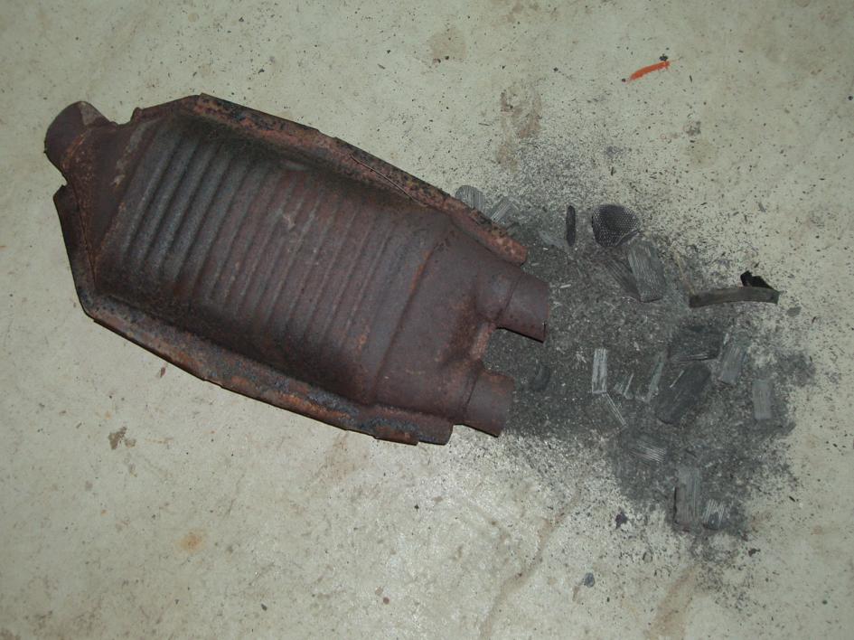

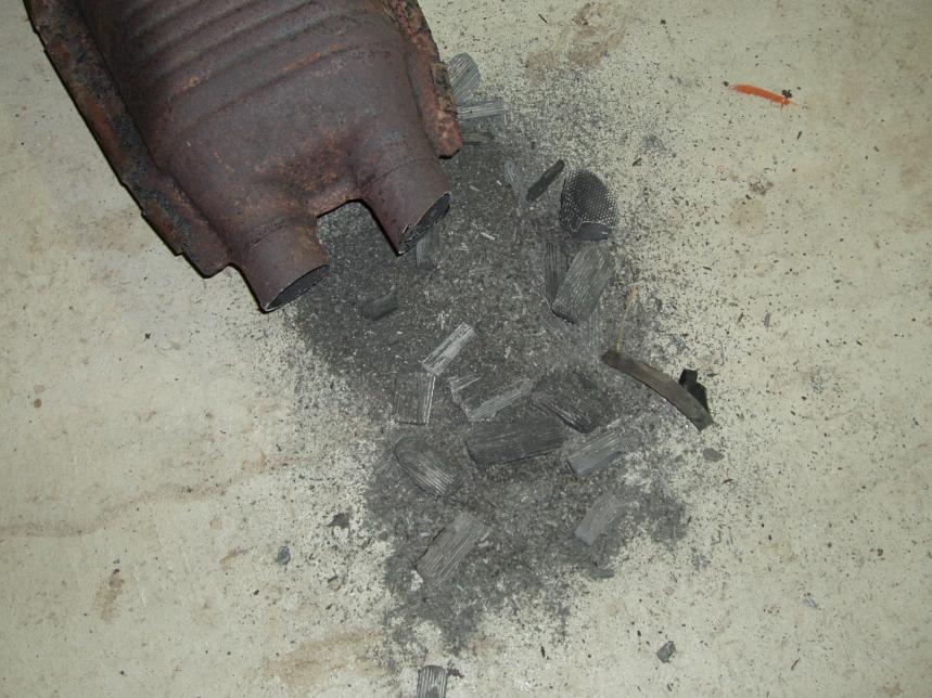

The cat doesnt seem to have any carbon or oil, it looks like it just disintegrated. It just poured out onto the floor in pieces. Is it possible I dont need a new intake gasket?
Pull the throttle body, and have a look. If you see pooled oil in there, you need the plenum gasket.

Those pics say it all about the lower intake gasket.
