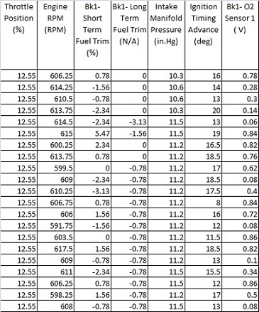

Did some more data logging.
I found that my Ignition Timing Advance is bouncing around between 10º and 19º at idle. This seems like a lot of fluctuation to me, is this normal?
Attached is a picture of the data I logged (click on attachment to view full size). This data was taken over a period of about a minute (on intervals of about 2-3 seconds).
As you can see, idle speed is not constant and varies from about 590 to 630 rpm. This is the reason I am logging data (to resolve a funny idle issue).
Could this be a bad Cam Position Sensor? I replaced the timing chain with a new double roller timing chain about 6-8 months ago (noticed an overall improvement). No loose timing chain noise now.
Could it be a PCM issue?
Any input would be appreciated.

That's fine for ignition timing at idle. The" fuel sync" is the one affected by the timing chain. The pcm does ignition timing and will adjust it on the fly for air temp, barometric pressure, coolant temp, throttle position, etc., etc. You and your tuner question, LOL. You're like a kid with a new toy!

That is normal for the timing to bounce around like that at idle!!?!?! Holy cow. Are you sure about that Aim?
Yes, I have been having fun with my new logger... the only problem is, I don't know how to interpret any of the info it gives me!!! Any signal that isn't perfectly stable makes me think something is wrong. Luckily there are some patient people on DF.

Yes, ignition timing gets pushed and pulled a lot, as the O2 sensors tell the PCM to richen/lean out the mixture to maintain the proper A/F ratio for fuel economy purposes.
