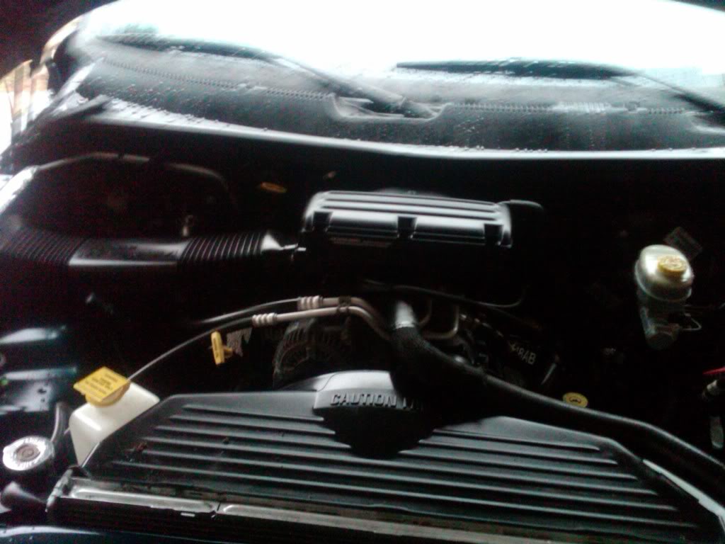

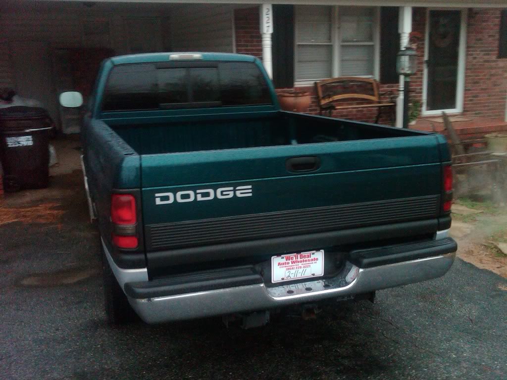

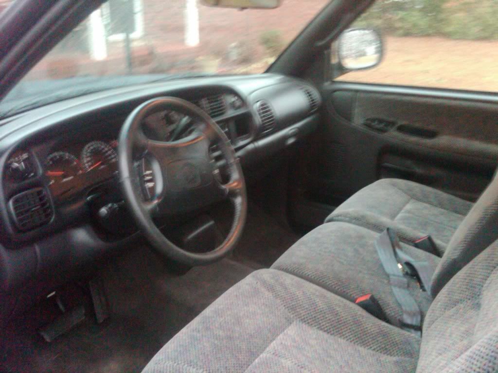

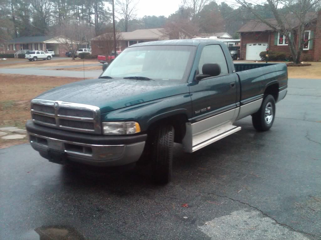

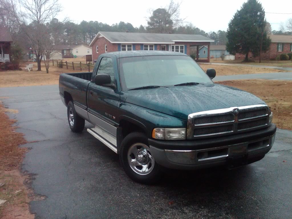

Hey guys, just got a 1999 Dodge Ram 1500 Laramie SLT 2wd with 65,000 miles with the 5.2l Magnum V8. its my first vehicle an I dont know much about Rams at all. its completely stock, so Im definitly gonna get it Line-x when i get the money an plan on gettin a CAI, lift, exhaust, paint job an anything else. So wht do u guys think i should do to it. Any suggestions? thanks in advance. sorry for the crappy cell phone pics.

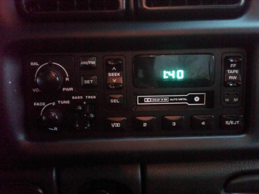

now i definitly need to put in a aftermarket sound system cause this thing is just cassette and the speakers arent that good either

do a search on this site for plenum leak, sct tuner, and 180 degree stat. these will give your dodge a little more power back.

This should get you started. A little preventative maintenance will pay off in the long run, and you will get more familiar with your truck. Nice truck btw, very clean interior!!

Welcome to DF, nice truck. I'd take those running boards off,

+1, they look a bit awkward, and taking them off will make your truck look a bit higher

I'm not planning on lifting way high like guys here do. just 'level' it cause i think it sits way low. But it might be those running boards. And i plan on taking those off real soon
