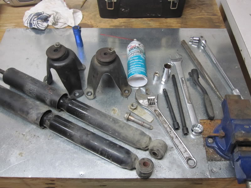

Here are my tools.
The only socket you will need is a 5/8" for the shock lower stud bolt and a 15MM for the three nuts on each of the shock tower. You will need some extensions for both the tower bolts and lower shock bolt and also a decent cheater bar depending on chassis corrosion.

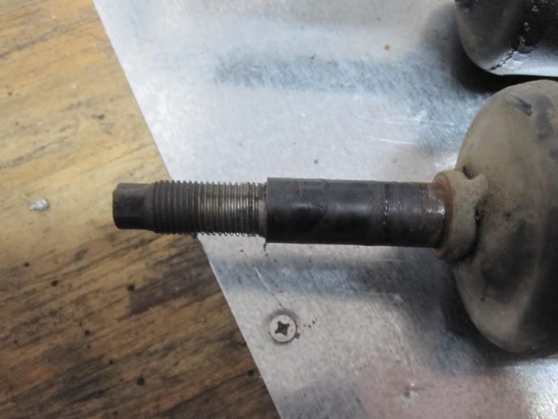

Now you have to seperate the shock tower from the shock. The tip of the shock is a hexagon and this best done by putting the tip of the shock in a vice, squirt it with some PB blaster and use an crescent wrench to remove the top nut. Now you have removed the shock.

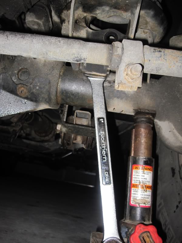

The passenger side is a little more difficult cause you have to deal with the brake reservoir. What you will want to do is place a 1" wrench between the axle and the lower shock mount and press up to compress the shock. The shock sits in the crotch of the wrench. Push the shock to the side of the spring. This will allow you to remove the shock and shock tower without having to remove the brake reservoir.

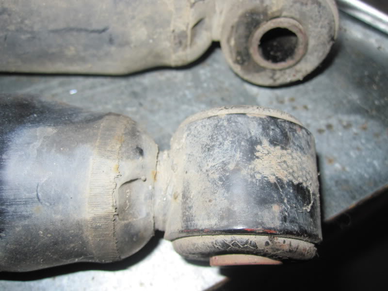

My suspicions were correct. The bushings are pretty ragged out:

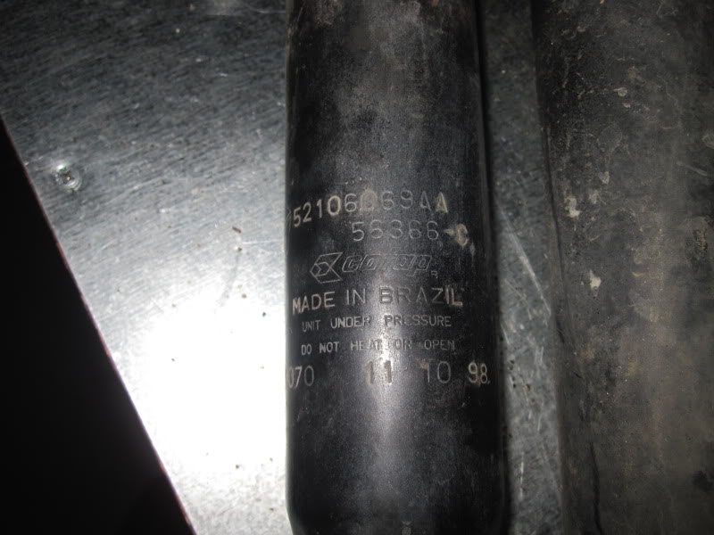

And would you expect anything else from a pair of 13 YEAR OLD SHOCKS!!! WOW

Here are my tools.
