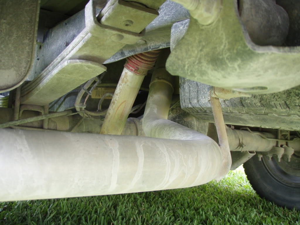

I got it done and went with 2.5" pipes they ran it along the passenger side, I had a magnaflow muffler that has the X-pipe in it installed, only needed one muffler and took care of x-pipe at same time, that was right after cab, then the pipes are ran over axle and go there seperate ways snaked around where the spare was and the hitch and come out in about factory location
heres a couple pics for thought
