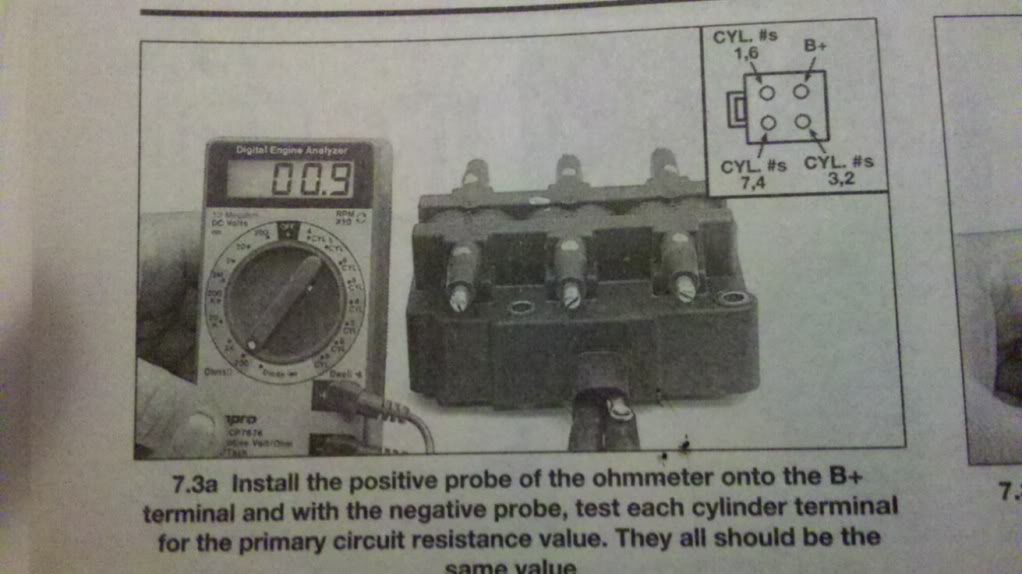

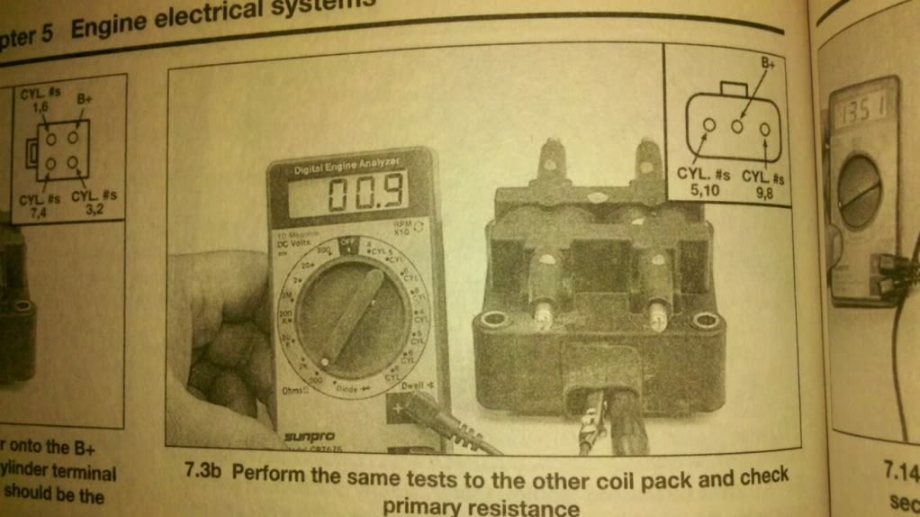

to check primary side of coil pack put a meter set to Ohms, between pin B+(center pin) and coil 5,10 (left pin) you should get a resistance between 0.53 to 0.65 ohms.
repeat for other coils using center pin(B+) and right pin (coils 9,8)
to check secondary side you would put one lead on each side of the towers that share a coil. That is check the points on the left side 0ne at 12 oclock and the other at 6 oclock then check the 2 on the right at 12 and 6 oclock, resistance should be between 10,900 and 14,700 ohms.
