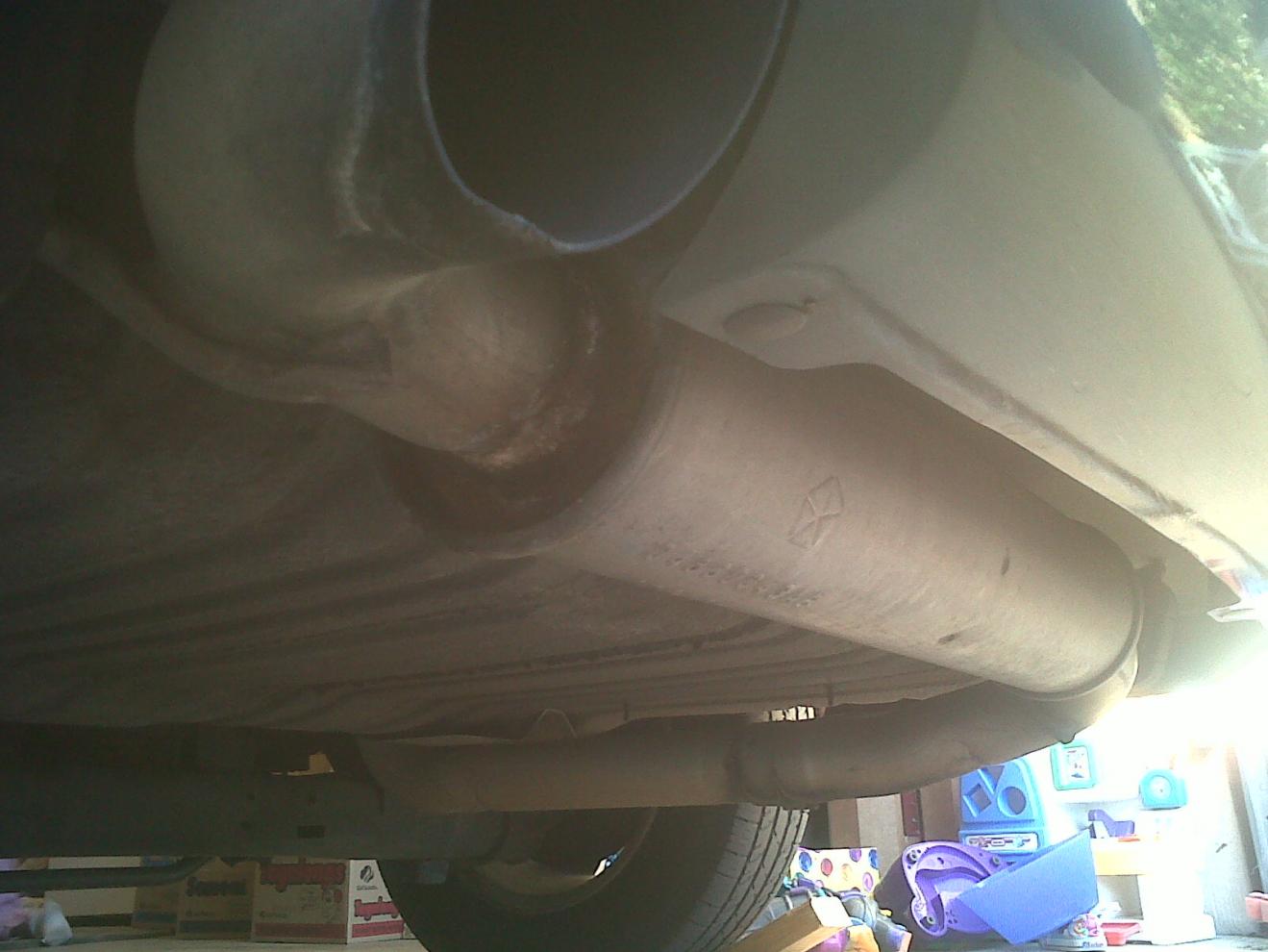

Please except my apologies for continually posting in the RAM section reagrding our van 3.8 ltr. 05 grand caravan with stow n go but there is good advice and knowledge here. I looked for the o2 sensors yesterday. I was expecting to find one before and after the CAT. The only one I found was sticking out of the top of the CAT. It is located right in the middle of the length of it. Going by my old Haynes manual (that goes up to 2002) and speaking with a vendor from this site today it is verified there should be a o2 sensor before the CAT as well. The one in the CAT is the 'after CAT'. I guess I'll look harder for the 'before' CAT. Seems strange that they would put one in on only one bank of the engine. The flange and Y coupler are right in front of the CAT so it appears as though that must be what they have done. Also, just so I'm straight on what all is in the exhaust system, please advise on what these things are pictured below. They are pictured in order from engine to tailpipe. Thanks.
First one's the cat, second one looks to be a gas tank, third is muffler. That seems to be an odd placement for your post cat o2. Looks like it'd be to far upwind to get an accurate reading... but then I'm not a dodge engineer (who knows what they're thinking). Pre cat o2 shouldn't be that hard to find for verification, follow the exhaust all the way from your headers to the tail pipe. First one you find is pre cat, second is post... that is unless you're set up for cali emissions, in which case there are 4

That gas tank looking thing is in the exhaust system. The tank on this is plastic on on the other side of the van. I've had it out before replacing the fuel pump. Another guy posted a diagram of where the 1st o2 is located. It's on top of the collector where the two manifolds come together; about 12" in front of the 2nd o2 sensor.
