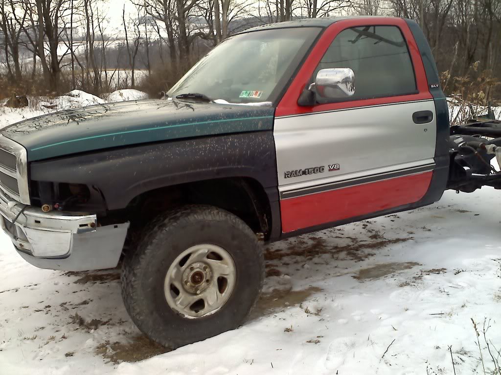

Outer? Interesting, especially with stock rims. What do they look like?
Got a picture? Pics are worth thousands of words!
the gaps in this pic are not adjusted,,,, but i have adjusted them since the pics,,,, the tires still hit,,,,

I shoulda been a but clearer...do you have a pic of the contact points...like the tire touching sheet metal?
Here's why...you'd be the first person I've seen that has that kind of contact with sheet metal with your combination.
Whats the actual tire size?
