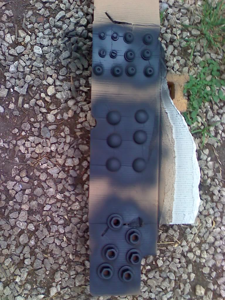

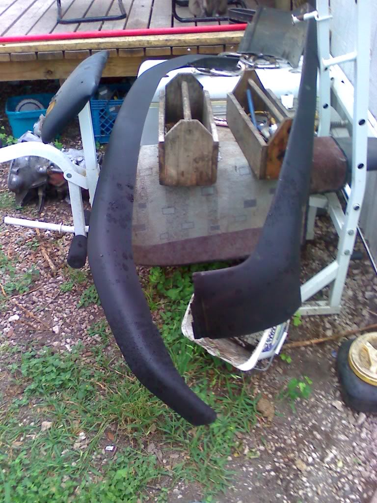

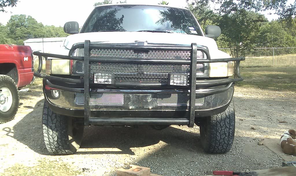

yeah i just used that rubberized under coating stuff, which came out black but dried almost brown, so i went over it with black spray paint. its starting to chip from all the massive bugs out lately, but still looks good.
i also soaked all the nuts and bouts in pb blaster and gave them a coat of black to match

That bottom piece looks pretty good in black. Wow, that's one big A$$ cow catcher on the front of that rig!
