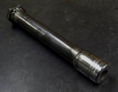

I had a nut welded on both ends. A larger (I want to say1 1/8" maybe larger, I wrote it down) for turning the adjuster, and a 3/4" nut to put my 3/4" socket on, then the torque wrench on the socket.
The tool cost me almost nothing, I gave the guy $10 to weld it, it only took him a minute or so. He didn't even charge me, I just tipped him. The other stuff I had. It was an old wheel bearing nut I used, from a Jetta (so it was probably really metric).

You can make your own tool with 3 simple pieces. Mine cost me less than $10 to make.
The adjuster nut size is 36mm, roughly 1.41inch or for our measurements 1 -3/8" here.
1. 7/8 inch Nut (outer diameter will be 1-3/8) A 36mm Socket will slip over this. $1.95 +Tax.
2. 1/2 inch Schedule 40 gas pipe that is about 6" longer than the axle. I could only get 30" or 48" pipe at my local lowes. I purchased the 48" and it is a bit long but will work. $7.50 +Tax.
3. 1/2" shaft bolt of about 2" long. $0.00 (had one laying around in my 50mm ammo can full of bolts and nuts.
