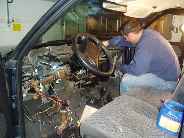

The service manual is pretty damn spot on. You can download the 2001 manual in the FAQ section.
My dad and I pulled out our dash in a day. Its as simple anyone with a brain can do it, just time consuming.
