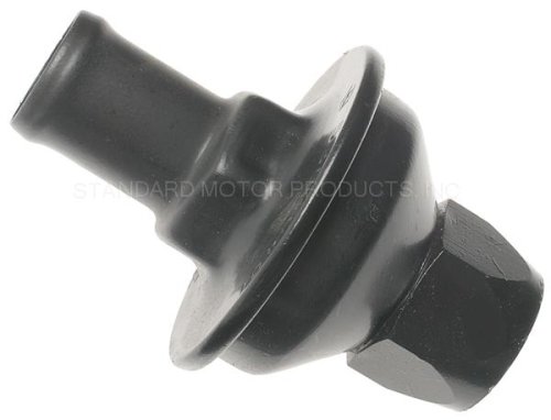

rockauto lists Air Check Valve - STANDARD MOTOR PRODUCTS Part # AV51 {#3512845, 53030467} for about $25. seems awfully expensive.
this threaded fitting is NOT right. this is not the little vacuum check valve.
