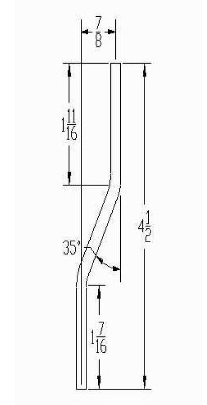

get a 1/4" by 20 all thread rod from your local home improvement store of your choice. here are the "S" bolt dimensions:
