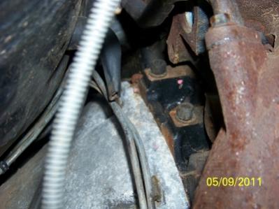

I think this is the flange or posts you are talking about but there is no hole in the bell housing.
I'm also thinking that we will have trouble with the flywheel being from a V6 and this is a V8 even if we cut a hole in the bell housing.
Not sure what the best step would be.

The LA is the generation of motors before the Magnum series. There are a lot of similarities but some definite differences. The Magnums are all multi port fuel injected and use the crank sensor that the older LA does not.
Those would be what I am talking about. Use a 1/4 allen to remove the bolts.
Yes there will be issues after you cut the hole out of bell housing. The V6 and V8 flywheels have a different hole pattern. Besides the old LA flywheel in there will not have any holes. You will need to get a V8 flywheel from a Magnum 318, nothing else, 360 will NOT work. I have no idea if your clutch will bolt to the different flywheel.
