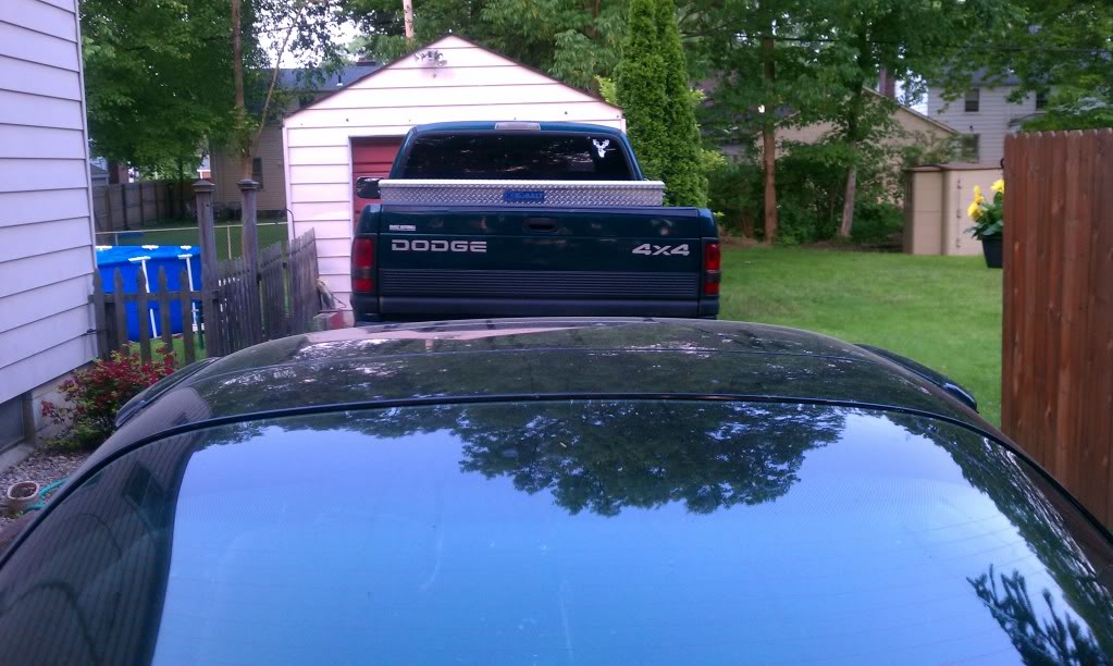

In this pic you can see the lean it has lol
