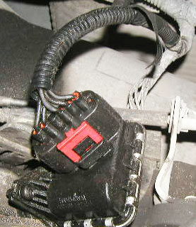

However he wanted me to send the pics from the Neutral switch
as he says there are two types. Just sent pics and posting them here as
well for any knowledgeable comments. Thanx everybody in advance.
N.B. Unable to post all pics , sorry.

Arrow Special Trany core - hard to find for this 3500 ????
Thanx - HeyYou - will discuss with my supplier about this TC issue.
Main problem facing me now is the absence of a core to rebuild.
My man says this trany is a special core due to the neutral switch as shown in the pic herewith.
Can anybody lead me to a place to get the right type core.
The trany is off a 3500 Canada built RAM.
VIN is as given first. Also the build sheet I got does not show the trany info.
Any meaningful comments will be greatly appreciated.
Thanx all in advance.
Old Jul 13, 2011 | 11:46 PM
Posts: 87,475
So far as I know, a fair few of those Canada built trucks made their way to the states as well.... there really shouldn't be a difference in the transmissions. (note: Shouldn't......) Should just be a 46RE...... though why they would even consider putting such a poor trans in a one ton, is absolutely beyond me.......
