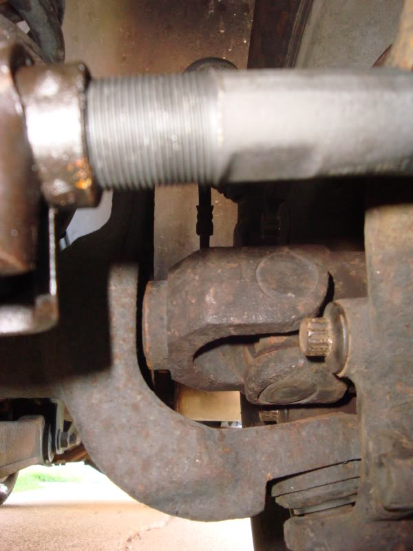

Here's a pic it looks to me that axle is sitting where it need to be?

i think it would be impossible to locate the big nut, stub shaft, and bearing in the right place if the axle was not engaged with the diff.
the picture looks good. make sure your 12 points are tight. those pull the bearing into the knuckle. then make sure that big *** axle nut is tight, something like 180-200 foot pounds and has a cotter pin or lock tab.
before tightening anything you should be able to feel some diff resistance if you spin the axle, since your turning spider gears.
after its tight, you can crank the truck, shift into 4wd, and IF the stupid CAD works, it will lock the passenger side axle. you can then turn the engine off, and spin the drivers side tire and see either the passenger side tire turn backward, or the front drive shaft spin. either one confirms the axle is engaged.
