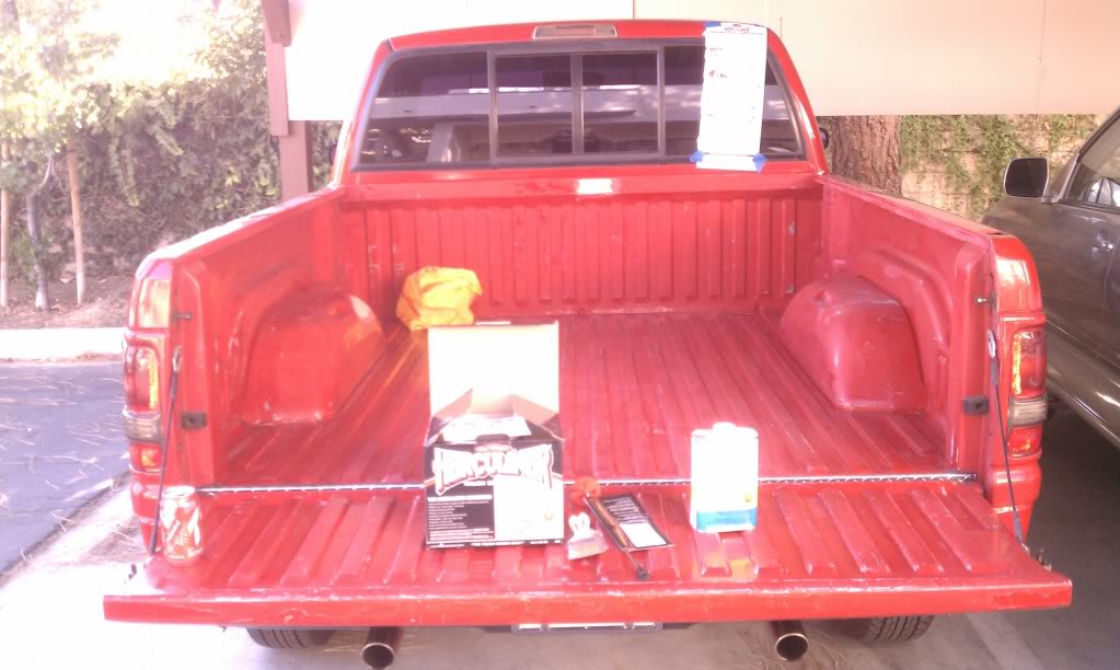

Herculiner always rocks just make sure to get allllllll rust grinded off before applying. Theres a guy on here that did his whole truck with this stuff. Grind everything you can and coat this stuff over it. you can get 4 gallon kits for 280 on ebay heres my bed:
before herculiner
after herculiner
