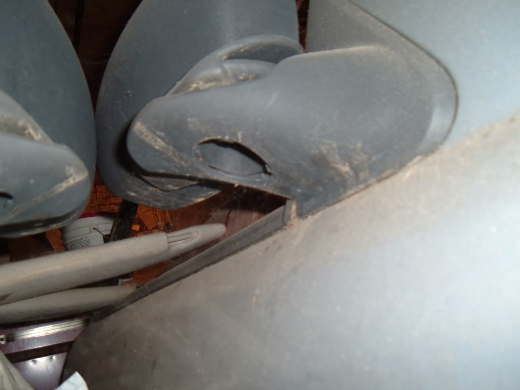

He says he has plastic mirrors. They didn't have plastic mirrors in 96. I think we need a pic. And here is a pic of the stock mirrors from my 98 1500.

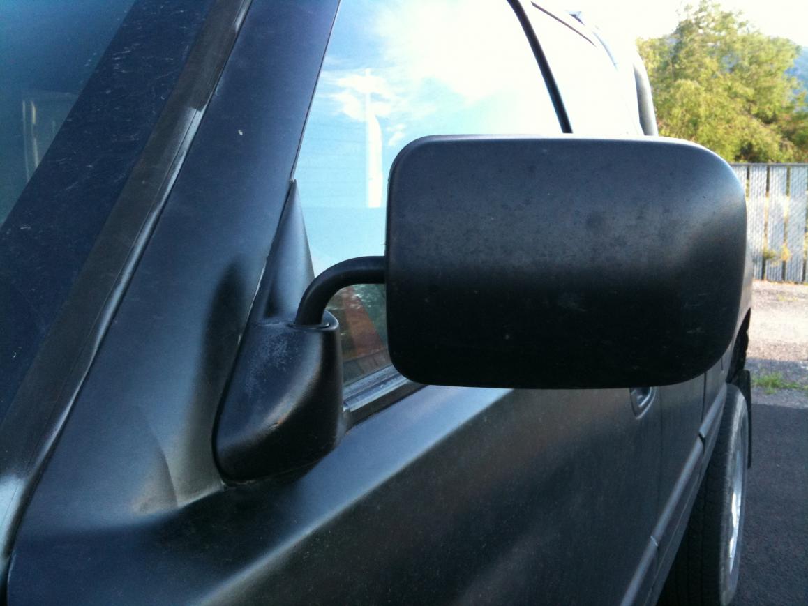

my truck must be a different model then yours is, because my mirrors dont look like that. it has a curved "L" shaped bracket that connects the mirror to the door.

lets see if this works
Old Aug 25, 2011 | 10:34 AM
dodge dude94's Avatar
dodge dude94
Banned Goober Smoocher
Joined: Jun 2010
Posts: 8,916
There were two different varieties.
The SLT's got the nice chrome ones, ST got the black ones.
