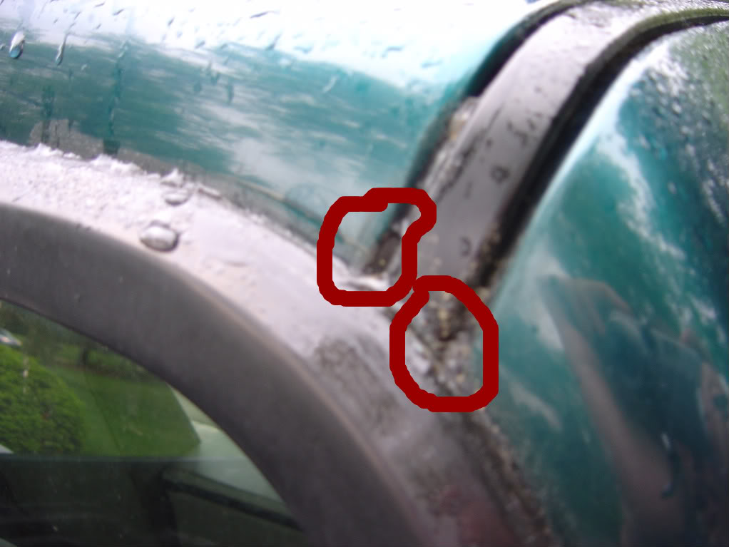

Pic courtesy of dodgeram07

wow thanks for the pic ill seal it right where you did.you think I should seal around the whole rear slider to?from the looks of that pic it looks as if he did.but getting a solid window I was thinking of also but sometimes I pickup up wood that wont fit in my 6 foot bed so if I open the slider It will fit in.out of all the ford trucks I had not one of them leaked from the rear slider of 3rd brake light so it has to be a dodge issue.grrrr great info thanks guys!

If it were me, I'd get a small cheap screwdriver and bend it. Slide it behind the gasket and stick the end of a tube of silicone in there and go around the whole window. (top and sides anyway).Same with those roof gaskets.
+1 that is just what I did. Same as the picture and around the sides and top. the stuff I used had a really solid tip and was real easy to get behind the rubber and just filled it up and cleaned up the little bit that squeezed out....
