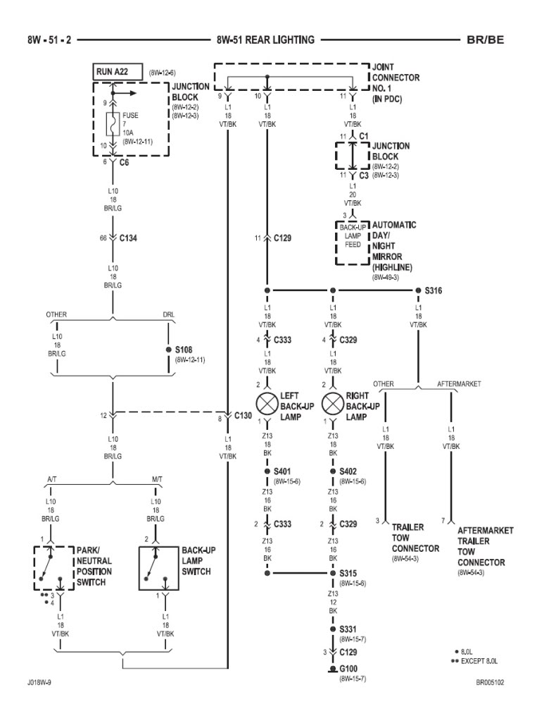

Hey peeps i have a 1998 ram 1500 with a 3.9L V6 and 5-speed trans i cannot get the reverse lights working the bulbs are good and there is power everywhere it should be but i'm wondering if its the switch in the trans. any diagrams would be great thanks for now.

You can grab the 01 service manual from the FAQ section here, it has wiring diagrams that should help ya.

thanks alot guys gonna try this tomorrow and ill keep ya posted
