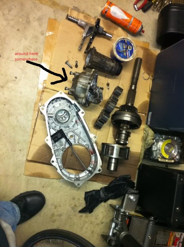

If i remember correctly it goes somewhere around were i made this picture up. A little sick today so again dont hold me to it but im pretty sure. Double check to be %100 positive.

LOLz!!! "somewhere here"

HEY NOW!!! lol i say that cause i remember when i tore mine down there was something very similar on the one shaft right around that area. Sorry im not more specific on were but that seems to be were i saw it
