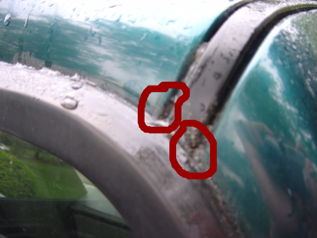

This too.

Originally Posted by zman17
This too.
is that rust? i was looking at that seal on mine - it didnt look all rusted out or anything. How does one go about sealing that area? Also - that black strip... what is it and does it come off / how do i re-seal it?

That's not rust, it's silicone to stop the leak.
