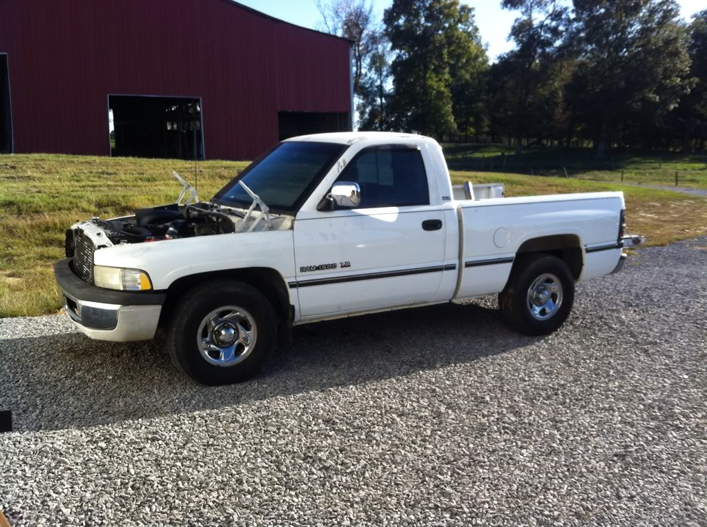

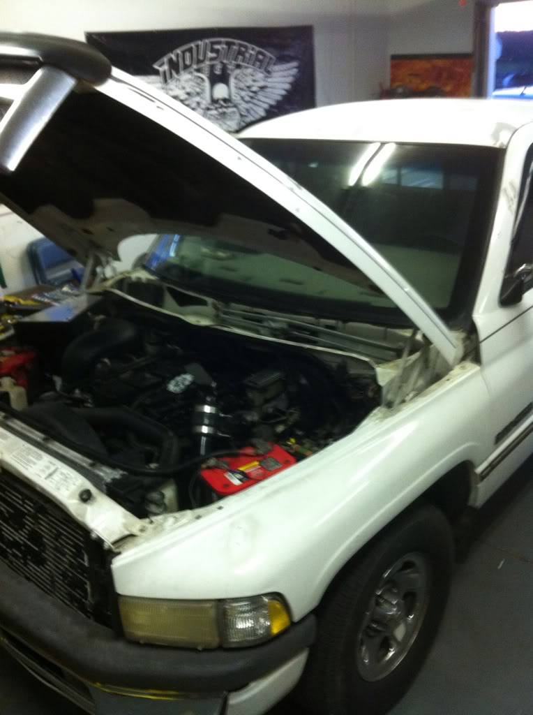

Your gonna have to post some video of that '94 1500 Diesel you got!

Right now, it's in the Shop on jack Stands. And I have most of the interior removed.
But here are a couple videos and pictures.
