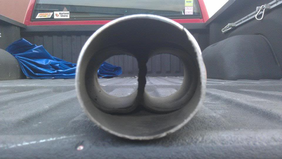

Yes, it's what you want if you are doing the Y for the 00-01 models. Some Y-pipes are very smashed and restricted where they meet in the 3" pipe and some not so much like mine. The 99 and older I beleive are worse. I just did mine and bumped up to 3" with the magnaflow Y-pipe and Cat and O2s, really didn't notice much difference as my old cat seemed to be working fine. I already had a hi-flow 3" muffler installed and that made quite a difference when it was done. I think some will notice more improvement depending on how smashed the inlet pipes are. We already have dual 2.5" to 3" at the cat, think the older ones are dual 2" inlet, so would make more difference on those models.
Our cat is 3" so you want dual 2.5in/3out.
Here's the y-pipe I replaced, not as restricted as I was expecting

Fyi Acrording the the articles I recently read unless your producing like 450hp+ the difference between 2" and 2.5 at the head pipes isnt noticeable....dual 2" pipes can move a lot of air as long as they are smooth without restrictions. things like the y, cat and muffler are still going to be the bigger restrictions as far as airflow.
beeker, those head/down pipes you are using are not mandrel bent, they appear to be restricted down to 2" at the bends anyway and this creates turbulence in the flow that way from what I've read...I would suspect 2.5" pipe with bends like that will flow just as restrictively if not more than true 2" all the way into the y pipe...plus I read that if you go too big on those head pipes with shorty headers the scavenging effect is diminished.
