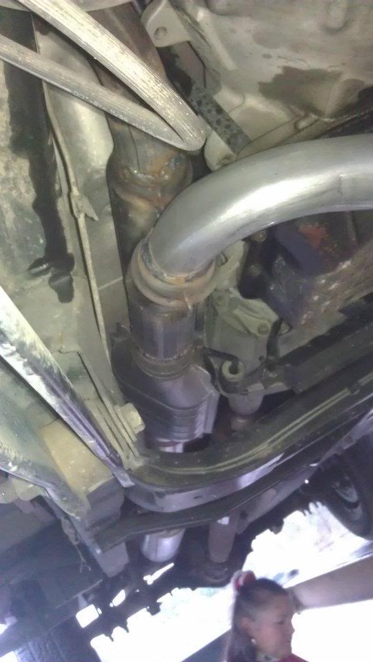

I finally got my exhaust finished today. I took the advice of many on here and cut out the factory Y-Pipe and replaced with the Magnaflow. I now have dual 2.25" inlet and 3" outlet. It then goes to a new 3" Magnaflow converter and 3" high-flow muffler. My local shop did a great job. It sounds a little deeper but not too loud. Very happy with it. Gonna put my new O2's in tomorrow. On the Magnaflow site you can find the 3" in/out cat listed under '01 Ram Van 1500 model 51020, OBDII. There's a pic of the old factory Y-Pipe too so you can see what it looks like in there, although I didn't think mine looked too squished at the end like some, the Magnaflow is a much smoother flowing by the looks of it and should compliment the 3" cat well

Originally Posted by Ugly1
Congrats. What is your impression of power improvements if any?
Don't know just yet as I was letting the cat go through it's first heatup cycle and wanted to be nice to it. I didn't notice any difference on the way home today but I kept it under 3K rpm. After I put the O2's in tomorrow and reset the PCM, I'm gonna take her for a ride and rev it up a bit and see what it feels like, that's where I should see a difference if any. I'll post back with an update.
