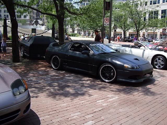

Here are some pics of my satin black job.
