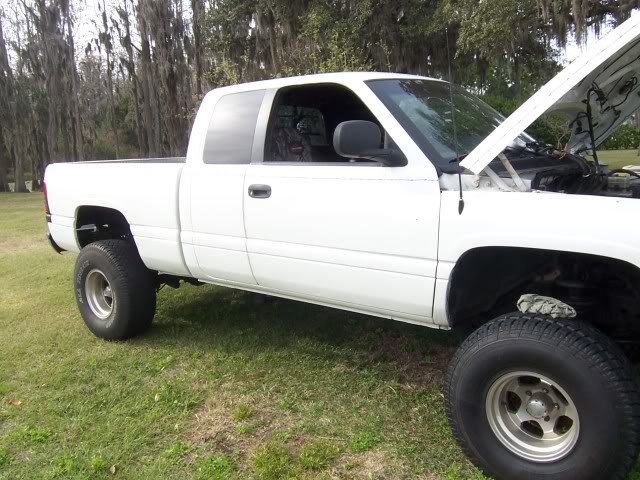

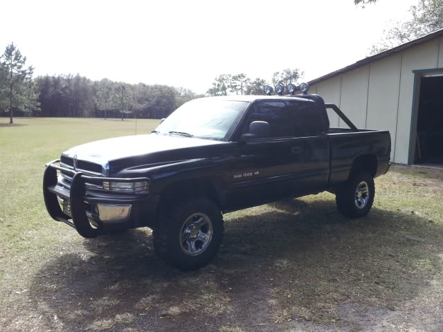

for other peoples opinions, 21/2" spacer or 3" spacer? will be order tonight or tomorrow morning? thanks guys

here is another good one to see the rack

I went 2"... and almost regret leveling it. Whenever you have a load, it looks over exaggerated. I prefer the stock rake vs the opposite effect. I ended up buying coil over shocks to the rear to help keep it level with and without a load.

Measure from center of wheel to lower lip of fender. Do the same for the rear. The difference is how much of a level you need.

I put a 2.5" spacer and brand new coils. It ended up higher in the front to where I'm putting an Add-a-leaf in now. But I like the height so whatever...
Just make sure you get new shocks if you do the spacer.

The 3rd gen wheels look good! I wouldn't go more then a 2 1/2".

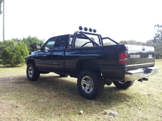

i put a 3" on my old 98 ram and it looked like this
of course that one had a body lift too.
just figuring the extra inch would really benefit me or not.. i mean, its just an inch ya kno..
and i measure from top tire to fender on front and back and difference is exact 2.5 inchs

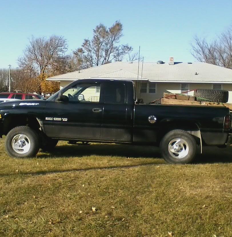

Sig pic: 2" level, no load.
This one: no level with 2500 lb. load. Just imagine the front 2" higher.
