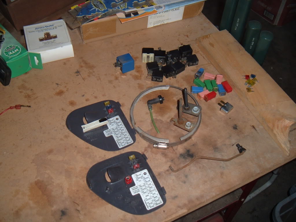

Take the cover off the fuse panel on the side of the dash. If you have a big blue plastic thing staring you in the face , that's the all in one flasher. It's in the top middle of this pic. Turn the key on and put your finger on it. Put one of the directional's on and see if you can feel it pulse. Then put the other side directional on and see if pulses. Should do the same when you push the e flasher light button.

And like a dumbass I forgot to post the pic in my other reply . I'm curios to know what year they changed from 2 flashers to 1. Anyway, heres the pic. it's the larger blue thing.
