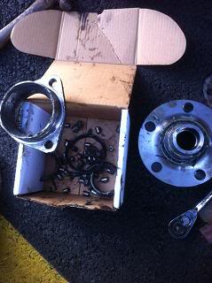

well. It was my bad. I noticed some wear on the Axel threads but it did tighten. (guessing it was its last leg) So when I tore it down today the nut was loose with a broken carter key. So now I am waiting for my new Axel shaft.. heres a pic.

the nut was loose how ?
as in the threads had peeled off and the nut slipped off?
or had the nut simply backed off, but still had thread engagement?
peeled back... ever hear the expression, "tighten it just before it breaks"
thats the only thing i can figure. had just enough to get it where it needed to be until it was driven
