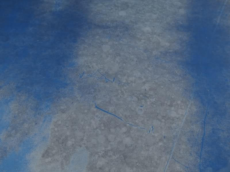

My 99's paint looks bad, real bad. Totally my fault as I've neglected to give it the proper care. It has a whiteish chalky look to the hood and roof. The sides look decent though. I thought this was the paint that had been "bleached" out by the sun over the years. The truck generally sits in the driveway for most of its life.
So, I was out the other day and went down an old path through the woods with overhanging branches and I could hear them scratching the roof as I drove. Surprisingly when I got home I realized the branches actually scratched through the chalky top layer to reveal some blue underneath.
What can I use to get the blue back all over? I know it won't be perfect but I'd love to make it look a bit better. I attached a pic of the roof for reference.

That chalky white is the clear coat deteriorating. Maybe someone with more paint/body experience can chime in, but I think you can wet sand with 1200 grit and apply new clear.

If it came off that easy with a branch, you may want to try and buff it out. Most of it will probably come off.

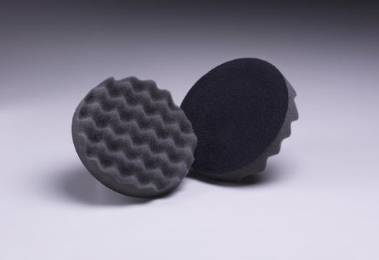

If the buffing process yields a blue residue (in this case) then you are through the clear and in to the base color. In that case, you would want to reapply new clear. If it can be buffed out with no color coat removed you can use a quality wax over it and let it ride. The trick is to not let the buffer sit in any one place for long, keep it moving and don't bear down on it. It too am a fan of the 3M foam pads...white pad for cutting, black pad for finishing. The 3M brand compounds seem to work much better too, followed up by 3M swirl remover, then wax.

You'll know immediately if you go through the clear. But use the white pad with that compound.

Correct, I just realized that my pics are misleading. The white pad with the compound shown...the black pad with the swirl (fine cut) compound.
