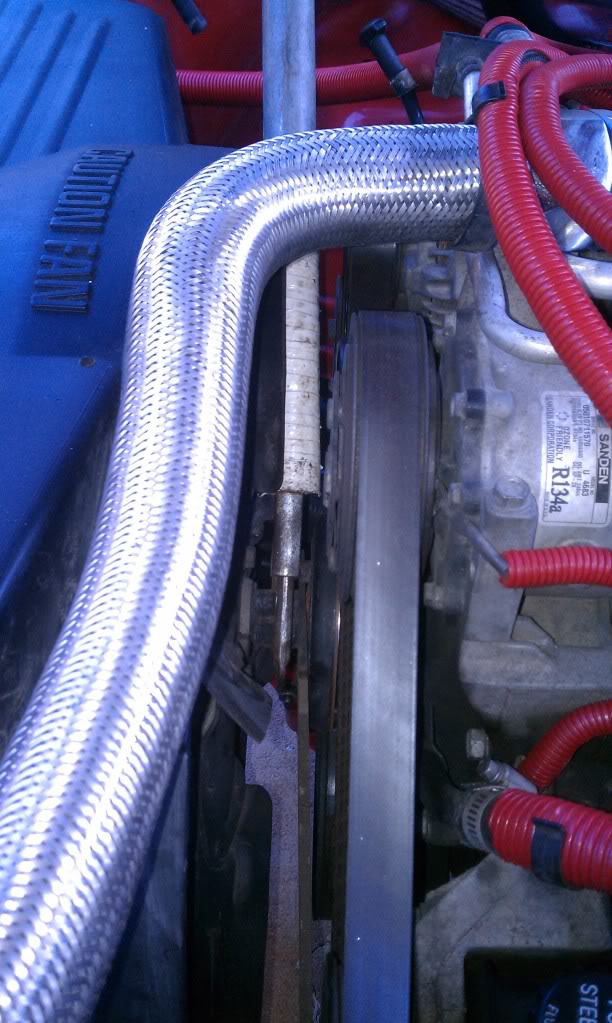

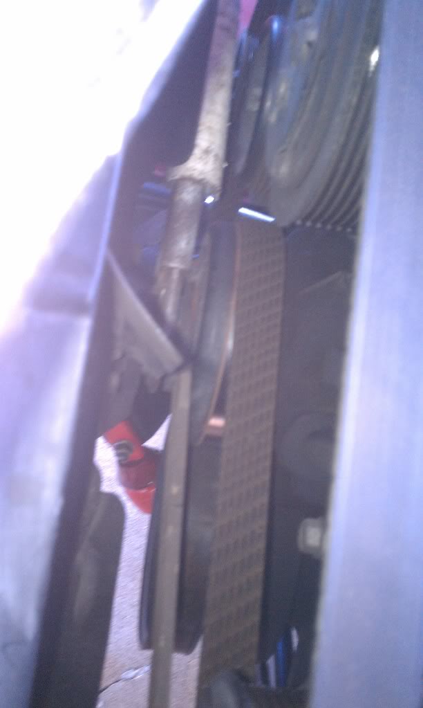

I just used a big ol metal file to wedge between two parts of the fan to hold it in place while i turned the nut counter-clockwise with a big wrench and a cheater bar. Only tip I can give ya is its on TIGHT and wear gloves so you dont break your knuckles. Heres pics:
