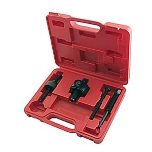

There is a neat little tool to pull the pulley, you should be able to rent it at your local parts store. You should be able to do it on the truck in about 30 minutes or less. (need the installer tool as well, but, my guess is, both tools will come in a box.)
Ok, I was wondering if the tool to install and remove were the same as the ones that you use for aligning (Pull out and push in).
