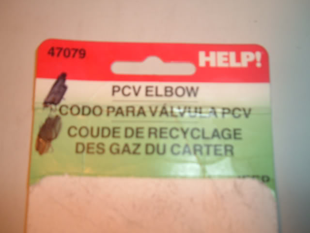

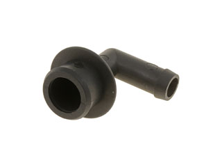

"plastic elbow piece" ? Name:  DSCF0498-1.jpg
That's a lot different than a "CRANK CASE INLET CLEANER".
