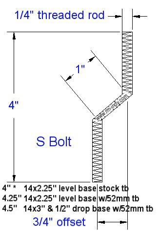

Just bought a 2000 2500 with a 5.9 gasser looking to put a 14x3 filter. and was wonderin if you can jus go to autozone and get filter and the hold down bolt? And as for exhaust was looking at maybe a thrush welded. Does anybody run one and if so how is the sound goin to gut cat at same time as well.

There is a sticky thread about air filters. you will need a piece of all thread that is bent kind of S shaped as the hole in TB is not in the center. There is a drawing in one of the threads.

Ok i found the thread. I cant seem to find what size all thread i need. Does anybody know? Nevermind found it

If you don't want to bother with bending a piece of all thread you can go to junk yard and grab the bolt off a older Dakota or ram and it has a bracket that bolts down to tb that's offest to center your air cleaner.
I have a couple of those That I would happily send the OP providing he lives close to NE.
That, and looking in the FAQ/DIY section would give all the info needed. Not to mention it won't do anything for the OP's truck. Except for having a loud sucking noise that I guess some people don't mind and a loss of bottom end. LOL
https://dodgeforum.com/forum/2nd-gen...-assembly.html
