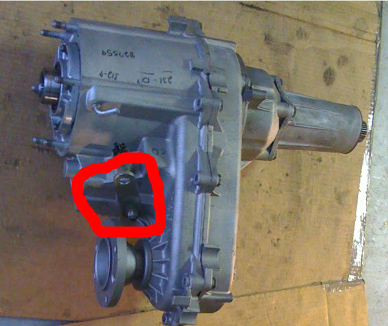

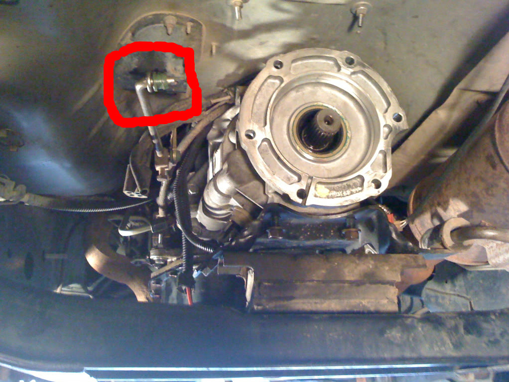

the automatic transmission replacement really shouldn't affect the t-case shift between 4H-2H-N-4L, as that's all transfer case. during a transmission replacement, the transfer case is removed, set aside, and then put right back in the original position. even the t-case linkage rod is disconnected/reconnected without any readjustment.
you might want to do this is you can. level ground, e-brake on, engine off - crawl under your truck and find your t-case shifter linkage. drivers side, very easy to see. if you don't see it, with engine off, have a helper shift the t-case while you keep your fingers out of the way. you'll see it move a 2-3 inch long lever on top of the t-case. it will have 4 solid stops, corresponding to 4H-2H-N-4L. each will make a significant "clack" noise when it hits that stop. if you get that good solid sound at each point, then your shift linkage is fine. for further invesigation, you can disconnect the rod from the t-case by simply popping the rod out of the t-case lever. it won't hurt it. do NOT adjust the linkage until you know for sure that it actually needs adjusting.
i don't have a pic of the shifter in the cab, but the 01 is very far forward when in 4L.
