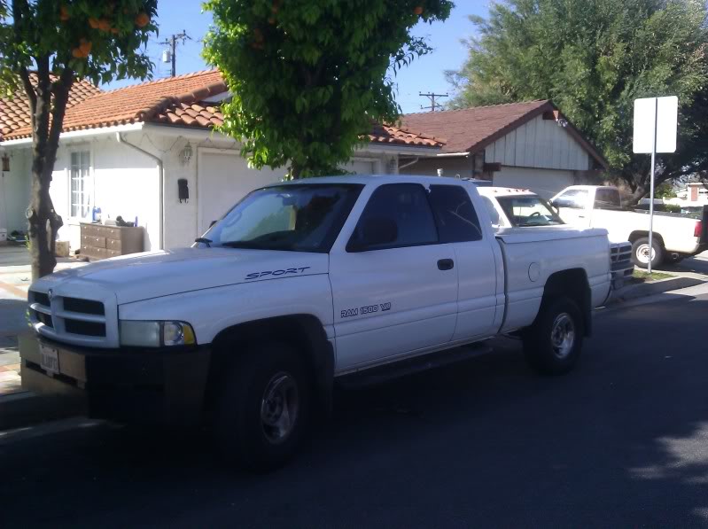

thanks for your help, everyone. I truly do appreciate it. Here's a pic of my truck...
If it wasn't for how good this truck has been to me, I'd probably just have sold it by now. I just can't seem to let her go.
