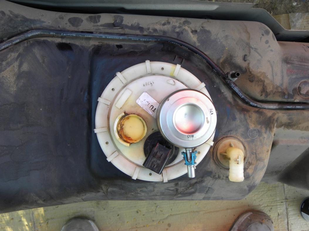

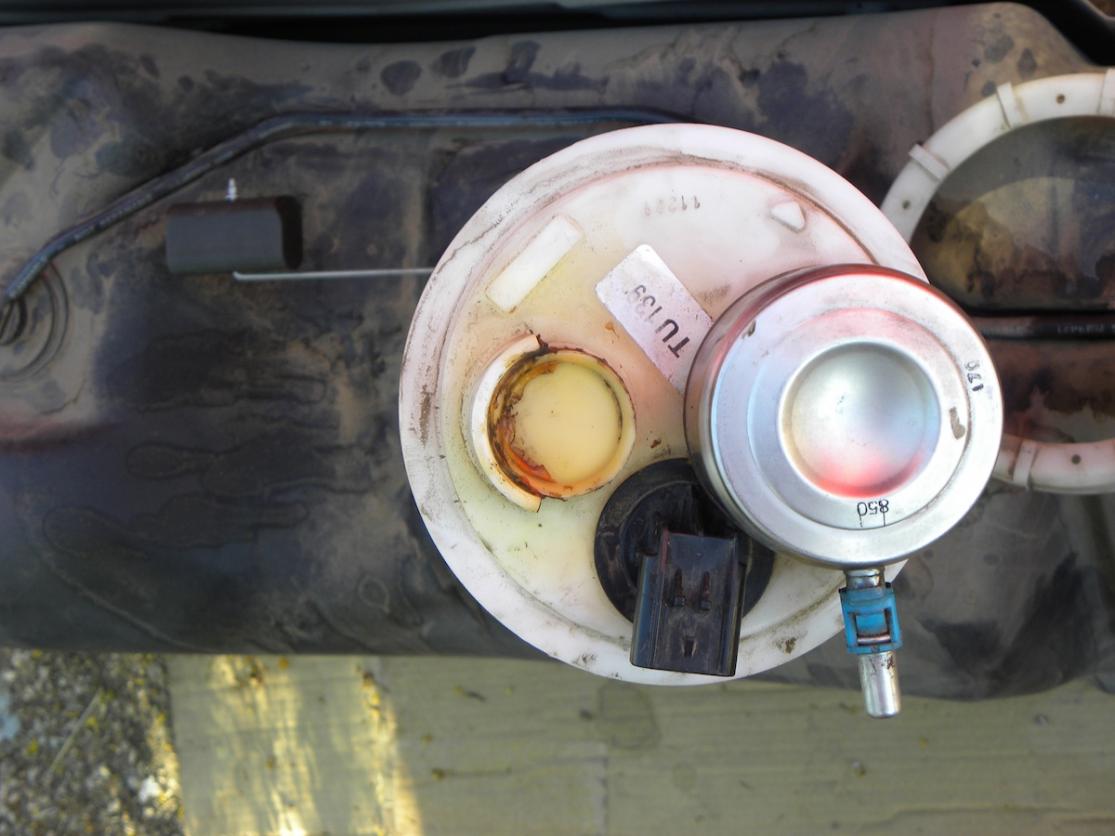

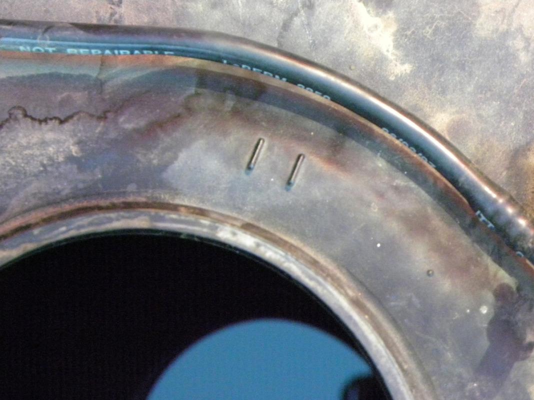

Default Got it!! Fuel Pump orientation solved!
I checked for the arrow on the pump and tank like you guys suggested and figured out what happened when we changed the pump last time. The arrow on the pump points at about 4 O'clock when viewing the pump from above and 12 O'clock is towards the front of the truck. This puts the sender arm pointing directly forward and swinging freely. I think that last time we had the arrow pointing towards the front of the truck which made the arm point back at 7 'Oclock and caused the sender to never read accurately. Made even more sense when I found the two little hash marks on the tank, which corresponeded to the arrow on the pump and the arm. So bottom line, arrow on pump lines up with the two marks on the tank and this puts the arm pointing forward. Heres some pics. I uploaded them as attachments, hope they come out OK. In the photos the front of the truck is left. Dach.
