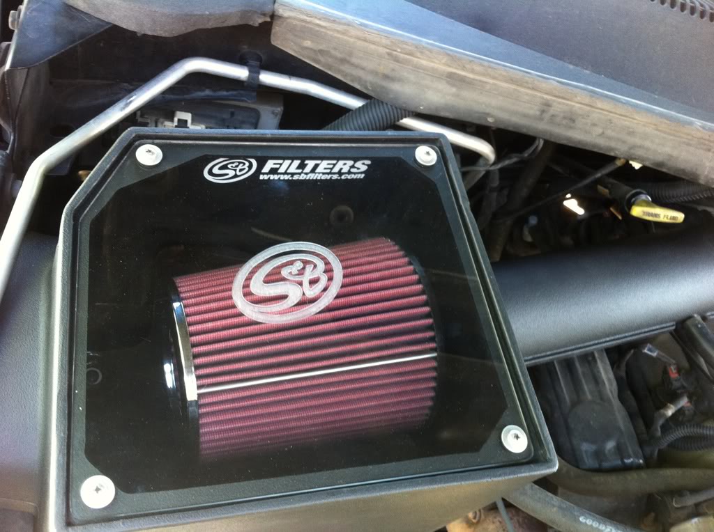

just cause it has a "heat shield" doesn't mean it still can't pull in the hot air. gotta remember that the top is still open. while it might be close to the hood when closed, its still open and thus still draws in the hot air.
only way around it is to get something like zman shows or this:

Yeah i really want a s&b cai but the cheapest i found was 206 bucks on ebay and i don't have that right now. That's why i was wandering if i could get this one and fab up some type of covering for the top:
http://www.ebay.com/itm/DODGE-RAM-15...item41647c1449
