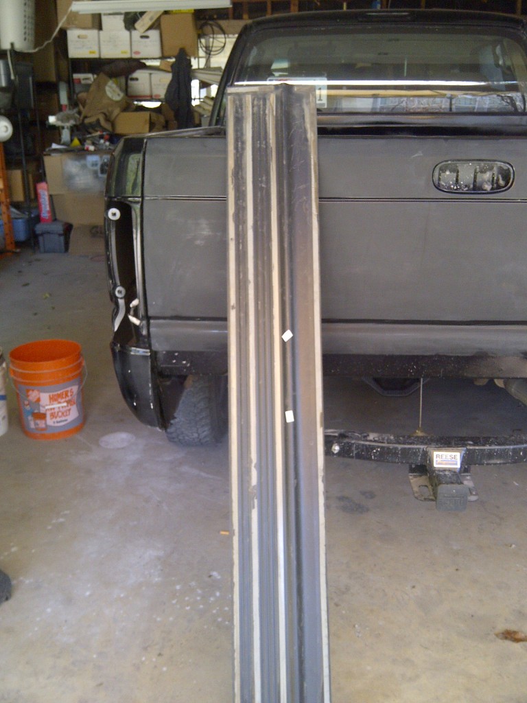

Heat gun on plastic panel. This phot shows where the double sided tape is located. Comnes off very easily with heat applied. No holes, fasteners, or damage to tailgate.
