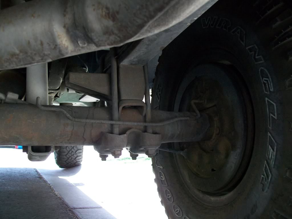

Block in th back is not 1" like it says in the instructions, its at least 2.5", will measure and get pic tomorrow.

Measured and got a pic, block is 3" high in the back.
Is this stock height in the rear, so I would need a 0" lift shock?

Those are stock blocks. You can go with the standard shock, or, the 1" lift fellers, either will work.
