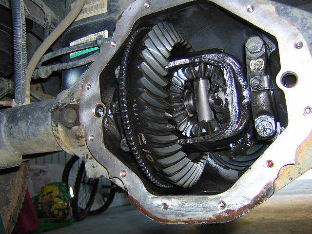

either your spider gears have broken and lodged a piece of the gear,
or
an LSD retainer clip thing has fallen out and lodged into the spider gear.
i would remove the diff cover, clean everything and inspect it. the retainer clip is sort of normal and the diff could still run another 100K miles. but a broken spider should be replaced.
DIY for diff service.
http://www.pavementsucks.com/tech-article-4.html
spider gear pics.
