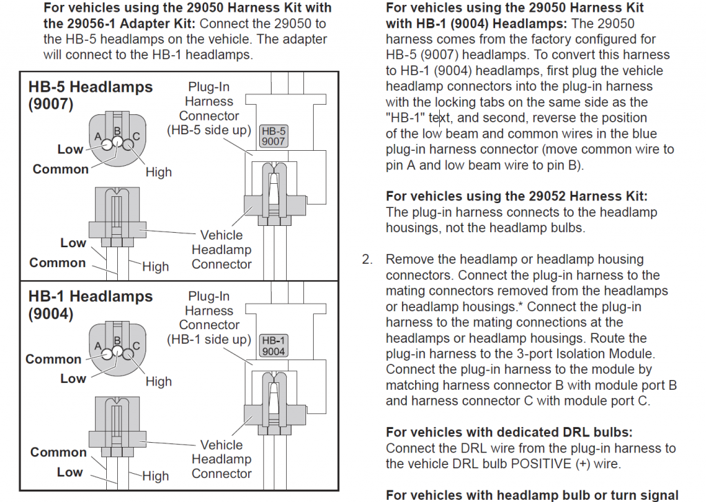

you need to switch 2 wires. give me a couple minutes, and ill find the info on fisher plows website. when i bought my new plow the new harness was setup for 9007's from the factory. i had to switch 2 out of the 3 wires.
here you go!!
