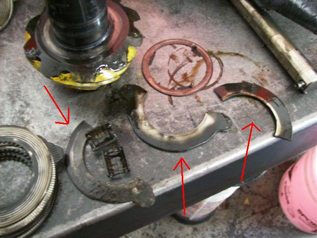

As for the rear diff, that piece isn't good. Do you have LSD? Does the piece you found look anything like this?
You might be able to reproduce the grind but putting truck on jack stands.

Hmm I will have to check on those. I don't know a whole lot when it comes to working on cars but I'm all about looking stuff up and doing it myself. I do have a LSD rear diff and the piece I have looks exactly like its a broken piece of the part you posted. What is that part? I would post a pic of it but I can't figure out how, I'm new to this forum as of today. But yea, it's a piece of that about an inch long. Is that a huge deal? And do you think that could possibly be the cause of the grinding noise? I'm looking into the driveshaft u-joint because that seems like a reasonable cause. Thanks for your help so far guys!

If the piece you found is what I posted, then your c-clip(s) are broken. These are what provide the pressure on the clutch plates. You will hear grinding from this b/c the edge of the c-clip is rubbing on the clutch plate. Those plates the the far left of my picture are the clutch plates. Notice the shiney surface? That is the result of the edge grinding off the ridges.
Your carrier is fine, so you'd really want to replace the LSD. There are better options out there, but I don't recall any brands to mention. Some people here have replaced theirs and maybe could recommend.
