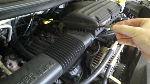

A photo of the loose wire is attached. I under-estimated, it's exactly 18" long. There are two others which disappear between the engine and the firewall.

Your pic is, I think, a ground wire that should go to the back of the head.
There should be a couple more grounds up by the power steering pump, coming off the main harness for the injectors, and such. If those aren't there, I would start looking for where they went.
